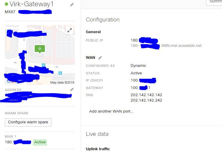

When I look at Uplink for my MX, I see a public IP and a WAN IP and both are different. Public IP is 180.x.x.x whereas the WAN IP is 100.x.x.x. I can ping the public IP from other hosts, but cannot ping the WAN IP. When I do a packet capture with a continuous ping to 180.x.x.x IP address, I do not see any traffic coming in to my MX even though the ping is successful. The ping to 100.x.x.x anyways fails and is not logged in the pcap.

Interesting! If you are seeing 100.x.x.x as the public IP on the dashboard, that means the Meraki dashboard is seeing traffic coming from this appliance with that IP. Definitely, something funky is going on with NAT upstream (probably only for certain routes and not all as we are seeing 180.x.x.x as public from a client behind MX)
That being said, since we are not able to ping 180.x.x.x from your computer, can you do a traceroute from your computer to 180.x.x.x and see where it is getting dropped? Also, it's worth connecting to a different ISP on the client side to check if it will make any difference

@Raj66
I see the WAN1 IP and Public IP as 180.X.X.X whereas the IP on the WAN interface is different. Please see the attached screenshot.
