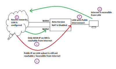

My requirement is quite different. Please find the diagram below where i have tried to explain my requirement. Please Pardon my Paint skills.
  • I would like to use MX only as a Load balancing and Failover.
  • Nat will be done on Existing Firewall and not on Meraki.
  • I must have Public IP Interconnect on LAN interface.
It would be great if you could let me know if above scenario is doable in anyway. Appreciate your help!

To disable NAT on the MX you need to run the Beta version 15. But it is still a firewall and you need to allow the incoming connections. I really would change my design as the MX is not really designed for this use-case.

I tried running Beta Version 15 as well, still LAN IP is not reachable.
And i do not see the option to configure Inbound rules.
Could you please assist where do we have to configure Inbound rules?

Hi @Bruce , We have upgraded FW to Beta version, Disabled NAT However the Public subnets configured on or beyond LAN port is still not reachable from Internet.
The Internet is accessible from LAN.
Is this default feature in Meraki where LAN subnet is not reachable from Internet?
The requirement is really simple. We need LAN subnets to be accessible.
