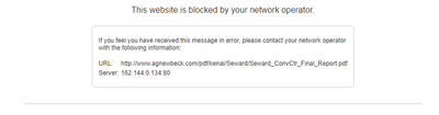

Can anyone tell me why this URL is blocked on our MX84?

Huzzahs are in order! My coworker took a look at the conversation we were all having and spotted the trail to the solution. I had been lost in the Content Filtering and hadn't fully realized there was a second blocking point in the Firewall section. He noticed we were blocking All Web File Sharing and he switched it to Binary over HTTP.
I hope this helps someone in the future! Thank you guys for all your help!

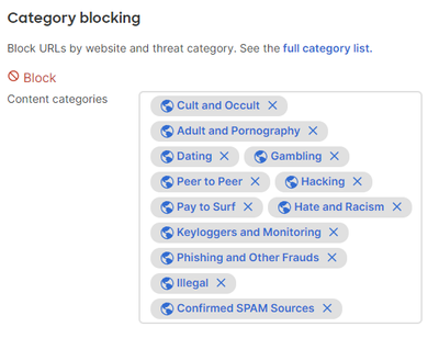

What firmware version are you running and what categories are you blocking? Version 16 doesn’t use Brightcloud anymore in favor of Talos.

Categories:

Nbar is wildly inaccurate right now. It likes to classify everything as peer to peer, including dns. That was a fun one. We've had to disable l7 and content filtering rules for peer to peer which seems to fix it for now.

Can you access the root domain of that site? I can hit that and the long link pdf from your screenshot.

Yup, same here. I also used nslookup to run it against OpenDNS and it didn't block it either (I use CIRA on my home network).
Actually yes, I can get to that site using the root domain! That's so bizarre. It solves the initial problem one of my clients had about not being able to download that PDF, but doesn't tell me why it's being blocked still.
