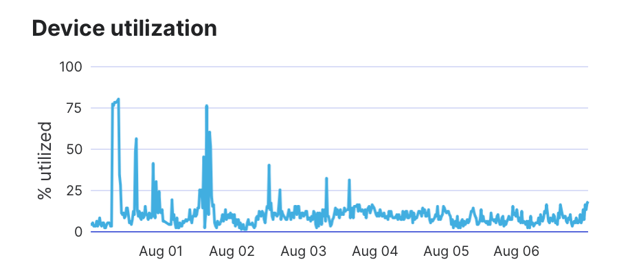

Hey all
I have a MX68 in an environment with a bunch of devices - average 130 clients a day. Half of these devices are LAN only ie NAS's, switches, IoT sensors, point to point bridge units. For those who know me, it's a retreat center. Recently, we've had a few larger groups come and the device has seemingly hard crashed. It has happened once every 2-3 weeks and requires a hard reset. Meraki support says the device is spec'd for 50 clients (insane for the money and I dont mind saying it out loud) and that it has been spiking high in utilization/CPU usage, like pegged high. I have nothing fancy going on.. a service VLAN and regular client VLAN, but not passing any data between them. Everybody on my network is texting, YouTubing, browsing the web and using web apps etc. Consumer usage. Ok so it is what it is. Support's suggestion was that if I didn't need one or both of the Advanced Security Package options to disable them, as the deeper packet inspection would raise utilization. We are an Apple/iOS/macOS house almost exclusively and when guests come honestly if they have PCs and don't have their own virus protection that's on them, so I decided to disable AMP. Looking at the event log in Security Center I have no confirmed positives, all clean. Looking at the utilization graph things do seem to have calmed down significantly but I havent yet been able to test it with a high influx of guests. If this continues, this will force me off of Meraki MX solutions and into something like Fortigate or Firewalla.
Any other thoughts or suggestions from this incredible support community welcome.
Here's the graph for the last few days. I turned AMP off on the 2nd of August. This is with standard client load of 130, with half of those being actual devices as I stated above.

Do you think disabling AMP is valid? I mean, do you think it's worth the risk despite not showing up at the events?
I think security is never too much, so I don't know if it's a valid option.
But it does make sense, if you have more simultaneous clients than the device supports, you are expecting high processing, I have seen this in practice.

I do think disabling AMP is absolutely valid. My users are 99% Apple and they are savvy enough to know not to install something strange from the internet. Im not worried about them and if PC users are on my network without virus protection thats a serious issue that I am not here to counterbalance. So yeah, I dont care at all about AMP. It is literally malware scanning, right? I still have the advanced intrusion protection on. High processing is fine, but the thing has been running for 2 years without failure.

Hi @RumorConsumer , so it looks like turning off AMP helped a little?  Has the device frozen/bricked since then?
Do you have anything internal on the network that you would class as the “Crown Jewels” that needs protecting?  If not, then having AMP disabled is a small price to pay as this may alleviate the matter short term.  Mid to long term is the retreat likely to see the same qty of visitors?  If so, could be time to upgrade the devices.  Vendor choice is of course down to the retreats budget.

Yeah I would. A couple Synology NAS units that aren't accessible from outside the network at all and run DSM which is basically Linux. AMP seems to be mainly pointed at protecting Windows clients which I could care less about doing. The retreat will probably fluctuate to the 200s. It's so weird because it had been fine for so long.

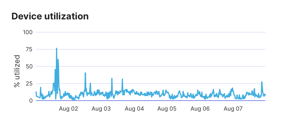

RumorConsumer
Head in the Cloud
My graph with AMP turned off on Aug 2, and wifi speed turned down from 120mbit limit to 80mbit limit since yesterday.

DarrenOC
idling along quite nicely then @RumorConsumer

Indeed. I will have as large a group as I'll ever have coming in the next few weeks. I'll see how we fare. Thanks to everybody for your help here.

DarrenOC
Just as long as you're not pushing it constantly above the 80+ % utilization mark you're good 😉
As @PhilipDAth states though if it happens again in a cyclical manner you could have a resource leak.

RumorConsumer
Head in the Cloud
Here we are having turned off AMP on the 2nd. I think that was likely the culprit...Screenshot 2023-08-08 at 11.29.30 AM.png

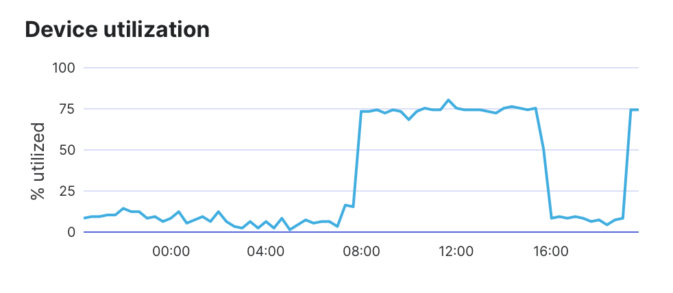

RumorConsumer
Head in the Cloud
Ok so my bandwidth is 250x250 AT&T Fiber and the max advanced security throughput for the MX68 is 300mbit. I noticed that one of my servers was doing some heavy duty video syncing to another site of mine (normal) but that it perfectly correlated to the spikes I was seeing this week. As an experiment, I used the bandwidth limiter on the server to throttle it down to 20,000kps. The results speak for themselves. 20MB/sec versus 30MB/sec but the utilization is WAY lower. It seems the increase in utilization is logarithmic as you get closer to capacity which I suppose may make sense. Screenshot 2023-08-17 at 11.18.46 PM.png

Well done for figuring it out!
RumorConsumer
Head in the Cloud
I can definitely correlate the high utilization to these file transfers. It's possible thats what it's been all along but Im not sure this account for all of it. Maybe. Definitely I was able to affect the utilization score this time around. I wish there was an alarm I could trigger at certain utilization thresholds so I could investigate.

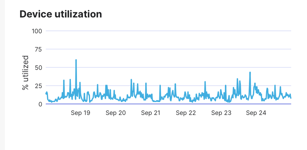

RumorConsumer
Head in the Cloud
Stopped working again today. Lights are flashing on ethernet ports but no WAN traffic. I can pull up the page of the MX in a browser and it just thinks it isnt connected to the internet. It says "there is a problem". I hard reset it, and it's fine again. Had 10 or so people on a zoom call when it went down. I have currently 156 clients total. Many do nothing but sit there and blink here and there, very little data passing. Maybe average of 20-30mbit on a 250/250 AT&T biz fiber line. Firmware updated to MX 18.107.5, which has the AMP fix and AMP is off. Utilization during this time was under 30%. Support tells me on the phone Im likely pushing it too far with the client count. I cannot believe this. I know theres a sizing guide but Ive been doing this for years with no problem. I dont use any advanced features. I have 1 VLAN for switches (which is about 15 of the clients), 1 for clients, and I speed limit everything to like 80mbit burst at this point. The only thing thats changed is the firmware and the age of the device. I dont use VPN or really any advanced features. Any other thoughts? Support is going to RMA it.

RumorConsumer
Head in the Cloud
The two APs on the POE+ ports winked out again. Everything else seems normal. I decided to say screw it and put those APs on ports 5 and 6 on the MX68 with injectors. Just bypass the built in POE+ ports altogether. I had seen this before on the other hardware I had and I figure it must be something related to the firmware if it's happening on both units. Hopefully this will be the end of it.

RumorConsumer
Head in the Cloud
Update again 7 months later - flawless operation with the same firmware I downgraded to. Works perfectly not a single hitch. Totally a firmware thing. 16.16.9
