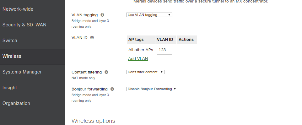

My Solution was to purchase a MX84 /
Create a separate network in my dashboard /
Create DHCP pool for VLAN on MX84
On the MX84  /Addressing & VLANs /Per-port VLAN Settings / Tag LAN port (to Core) with VLAN ID
Connect the MX84 to my Core MS425 Stack & tag the port to the SSID VLAN /  - and have my Public SSID tagged with the new VLAN ID.. BAM! Tag LAN port on MX84 to VLAN128Tag LAN port on MX84 to VLAN128Connect LAN port to COREMS425 w/tag 128Connect LAN port to COREMS425 w/tag 128Create DHCP pool on MX84Create DHCP pool on MX84Wireless SSID VLAN ID 128Wireless SSID VLAN ID 128
