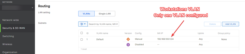

All Workstations reside in the 192.168.100.x subnet (VLAN 1)

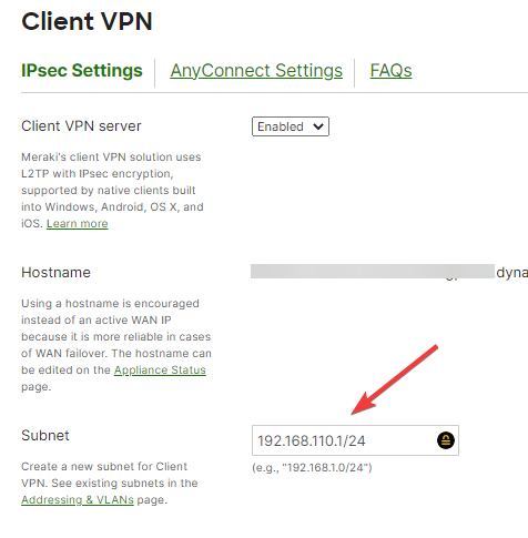

Once a client connects from home, he gets an IP from subnet 192.168.110.x.

I also don't have any dedicated VLAN for the VPN (Under Routing); I only have the default one.
Do I need to add here the VPN subnet? or it`s enough for the "Client VPN" page to configure it?
Adding pictures to show my current configuration
