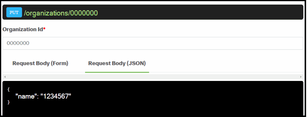

ECMS practice question
Refer to the exhibit. What is the expected result of this Dashboard API call assuming the response to the call is 200 OK?
  1. The selected organization ‘id’ parameter will be updated to 1234567
  2. A new organization named 1234567 will be created
  3. A new network named 1234567 will be created inside the selected organization
  4. The selected organization ‘name’ parameter will be updated to 1234567

The correct answer is D!
If you what to give it a shot and test this API call -> https://developer.cisco.com/meraki/api-v1/#!update-organization

Good question this week; it's going to upDate the name of the organization to 1234567 I believe.

This is where i fall foul but I'm going for D

I had to think twice, but then it is quite obvious:
Spoiler
"PUT" updates an entry, but the ID can not be updated as this entry is generated by Meraki. To create an organisation (or a Network) we would need a POST. And with this only "D" can be the answer.

D for @DavidLowe  is the answer.

My first go at this and I think its D.
