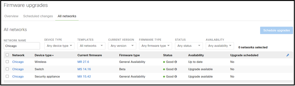

Refer to the exhibit. Which of the following statements is correct?
  1. The Chicago network is bound to a template
  2. Switch and Security appliance in the network will upgrade at their next reboot
  3. Cameras for the Chicago network are not shown in the firmware page because their status in dashboard is Dormant
  4. The user currently logged in has Org level administrative access

🥁::drum roll::🥁
Correct answer is D!
Thanks to everyone who participated, honorable mention to @DarrenOC for turning down, one by one, all the wrong answers 😎.

Has to be D
The output doesn’t show the Chicago Network as being bound to a template.
Devices reload automatically once an upgrade is applied.
Regardless if they’re dormant or not they always show up in that view.
