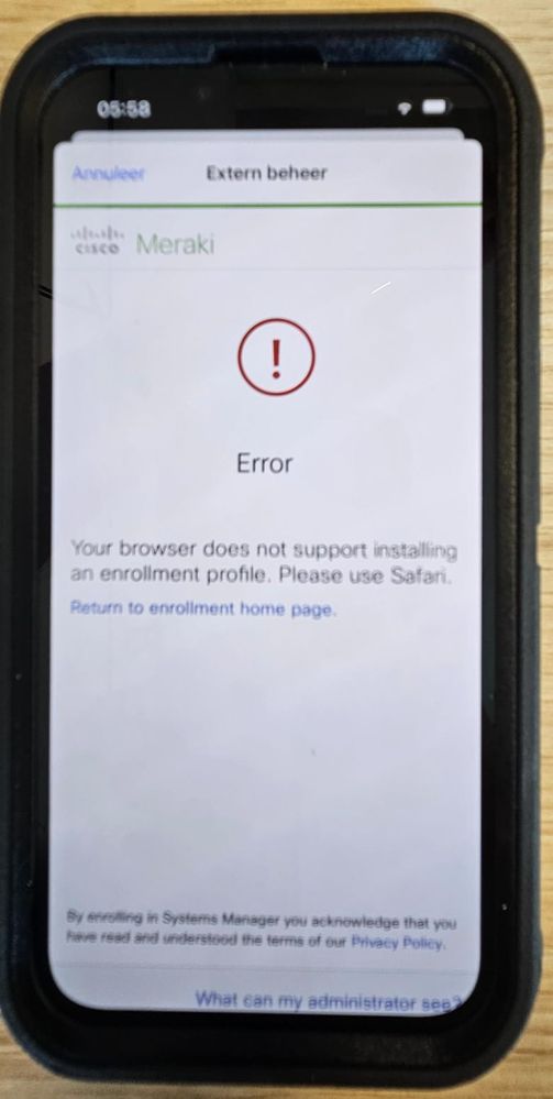

I have a simmiliar issue, brand new iPhone 16e with ios 18.5.
Did a factory reset and from the initial setup deployment with ADE i get the message "Your browser does not support installing an enrollment profile. Please use Safari"WhatsApp Image 2025-07-17 at 14.58.57.jpeg

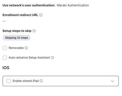

@MRTNand @CWDouglass  Do you have an Enrollment Redirect URL set up within your ADE settings?
If so, try setting it up without one and see if the process completes.
Found this helpful? Give me some Kudos! (click on the little up-arrow below)
MRTN
Comes here often
Thank you Vassallon for your response, I missed it.
I did not have an Enrollment Redirect URL.
In the end it I did a nother full factory reset (with the Apple configurator) of the device and then it worked.
