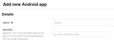

Regarding your "custom app constantly reinstalls" issue: It's imperative that, as below, your Identifier matches exactly with the identifier of the application
If this is even slightly different, SM cannot determine that the application was installed and will attempt re-installation
