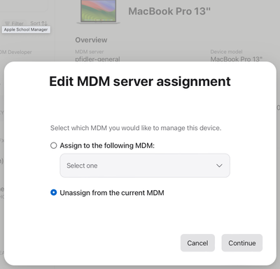

This is only true if you are using Apple's ADE. To ensure, if the powers that be decide not to buy a license, that you edit the MDM server:
This will ensure that it doesn't try to enroll again after a wipe
