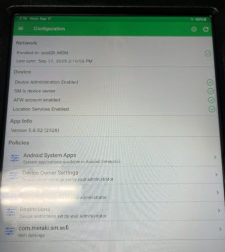

Got the device set into the "device owner" mode. Logged in as my user to system manager with green check marks on all the items.  I am however unable to see the tablet in my devices menu.  I believe it has a license assigned to it (I'm testing with 2 devices so I am using 2 of 2 licenses). I'll see if I can figure out how to verify the license between the device and MDM.  I must be missing something simple. 🙂
NickDickerson
I was able to track the device down by going System Manager > Configure > tags > enrollment type > Android fully managed.  I have a tag I've been using for the tablets and noticed it was missing.  This didn't solve the device being absent from the System Manager > Monitor > devices, but at least I was able to find it.
