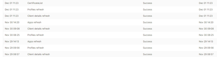

Hi Paul,
The APNS cert is still valid, the online status of a device that is working properly seems to be fine, the last check in was today.
Below are the logs for a device that isn't picking up webclips or any changes for that matter.
I see that the device hasn't checked in since the 1st of December
If the issue occurred before that date will the check in still be relevant.
