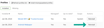

At this time, the wallpaper payload only allows the push of wallpaper but does not allow the wallpaper to be restricted.
You can re-push the wallpaper profile by going to SM > Devices > *click device* and scroll down to Profiles and select the "Reinstall" button. This should re-push the wallpaper to the device.

Also, even if we identify the device and  re-push the profile, the wallpaper is not restored.
One way to get the wallpaper back to original is to change the URL of the wallpaper settings and then push the profile.
