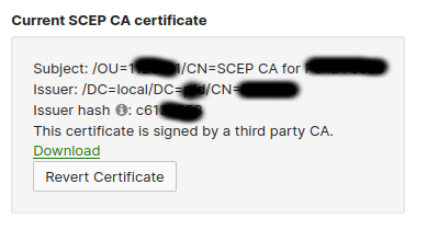

I've signed the cert using my CA and then tried to issue certs from that using a config profile

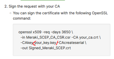

You need to generate a key:
6str1ngt3ch
yeah I followed that to the letter.  I extracted the private key from my root CA (I'm using Microsoft CA) in order to sign this with openssl.
Then I go to create a SCEP cert config and that's where things get stuck
I feel there's something in between that I'm missing but not sure

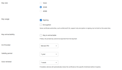

Secondly, you don't need to do any of the steps below. Just a SCEP policy, as below:
