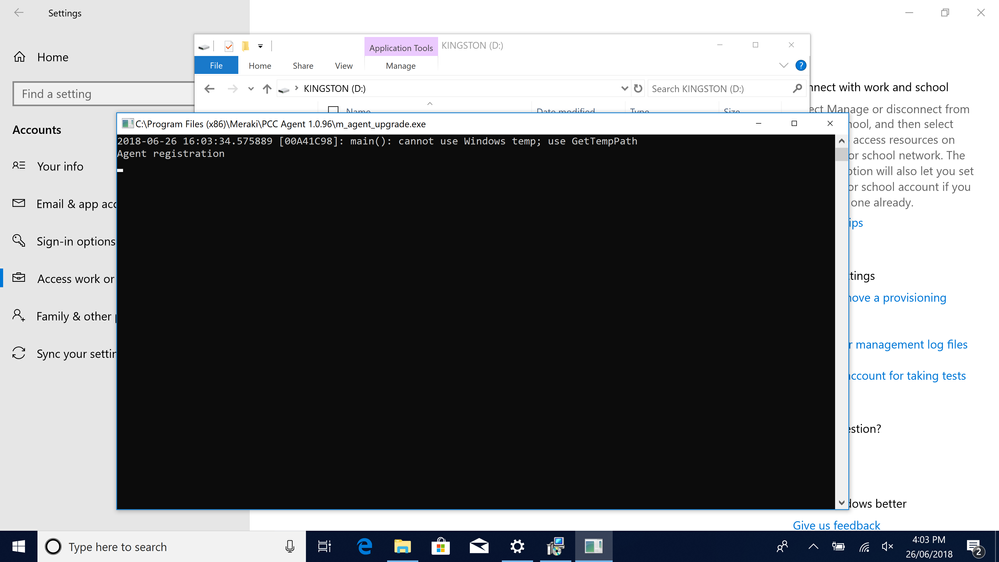

I am having some trouble with the Windows Agent installation. It seems to install fine however during the installation the following error pops up.
The error stays for a few seconds and then the installer says it has installed fine. The devices shows up fine in SM however I am unable to install any apps or a specific settings profile to the device such as WIFI settings, everything else seems to work fine (Remote control, process list etc.). Looking at the agent log files nothing seems to stand out.
I have tried 2 seperate Windows 10 pro devices which are fully up to date with no AV or AM software on either. Has anyone else had this issue or is it a support ticket to Meraki?

Finally seemed to have resolved this. The CMD prompt error seems fine and not a issue, from I can tell it can be ignored. To resolve the issue I had to do the following:
  1. Fully removed the profile and Agent and reboot
  2. Install profile and then install agent
  3. Reboot
  4. One of my apps had the incorrect install argument which was causing all the others to get stuck. Note that windows apps the install argument may be different for each app.
  5. Once the above was done apps started to install fine
