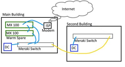

I have multiple buildings all connected through SMF to the main building. The main building has 2 MX100 Routers (1 is warm spare), and has the internet connection. I am unsure of the proper Meraki setup for keeping internet connectivity to a secondary building if the SMF gets cut or damaged, do I need to set up a warm spare at each of the buildings with their own internet connection?
Here is a very basic diagram i made for how we are set up currently, we have 4 secondary buildings. Yellow is SM Fiber.

You should either have another ISP connection at the secondary building as @alemabrahao says, or you could have:
  • Second fibre from primary to secondary building using a diverse route
  • Wireless point to point link between buildings
  • MG cellular router in secondary buildings along with MX.
4 Replies 4
To have full redundancy in both buildings, the ideal is for you to have an MX in each building configured in Warm Spare.
It is advisable to have at least two Links from different ISPs and preferably the router of one ISP is in one building and the other in the other building, this way you can guarantee redundancy in the event of failure of one of the ISPs or one of the MXes.
Remembering that there must also be redundant fibers to interconnect each building.

Actually I didn't say that you can have a second firewall as a warm spare.
What I'm talking about is to install a new pair of MX in the second building or move your secondary MX to the second building.
I think you're a little confused.
Today I have an structure of a client with 4 DCs, in each DC it has a pair of MX in Warm spare and all 4 pairs act as HUB.
