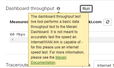

I have an internet line of 1 G coming from ISP. It goes in to Cisco SW on port 1. Then port 2 of that SW is connected to my Primary MX 100 and port 3 of the same SW to the Secondary MX100.
When I am doing a throughput test on both MX100 I am getting only 280 Mbps.
is this correct?
Thanks for your reply
Tazio
cmr
@Tazio4436 the dashboard throughput is only an indication of functionality.  The MXs generally can manage up to a couple of hundred Mbps, the MRs not too far behind but the MSs only 10-20 MBps, if you hover over the (i) it explains that it is just really a connection test:

Better connect a client to mx. And use  a (reliable) speedtest from there
https://documentation.meraki.com/General_Administration/Tools_and_Troubleshooting/Throughput_test_to...
