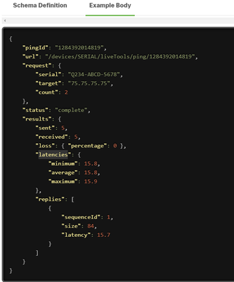

However after I do the GET request I don't seem to get teh full results. This is an example
{'pingId': '000000000000000', 'url': '/devices/0000-0000-0000/liveTools/ping/00000000000000', 'request': {'serial': '0000-0000-0000', 'target': '111.111.111.111', 'count': '3'}, 'status': 'complete', 'results': {'sent': 3, 'received': 3, 'loss': {'percentage': 0}}}
The results cut off without displaying the "latencies" or "replies" key/dictionary
https://developer.cisco.com/meraki/api-v1/#!get-device-live-tools-ping
Any ideas what the problem is?

Just noticed - only some of the ping results are incomplete. Many return the full data but some only return up to "results" and miss "latencies" etc
It seems the pings where data is missing all involve pings to or from 1 particular site.

I ran the ping ID of the odd sites pings manually through the meraki api dashboard and sure enough, the api is not returning the data 😛
all im getting is
"pingId": "111111111111111111111111",
"url": "/devices/1111-1111-1111/liveTools/ping/111111111111111111111111",
"request": {
"serial": "1111-1111-1111",
"target": "000.000.000.000",
"count": "3"
"status": "complete",
"results": {
"sent": 3,
"received": 3,
"loss": { "percentage": 0 }
If the status is complete and the pings were successful, why is there no latency data?
