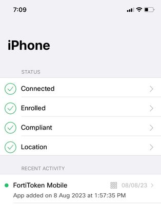

Do the devices have the systems manager app installed on them? If so open the app, you should have green ticks next to the four items at the top.
