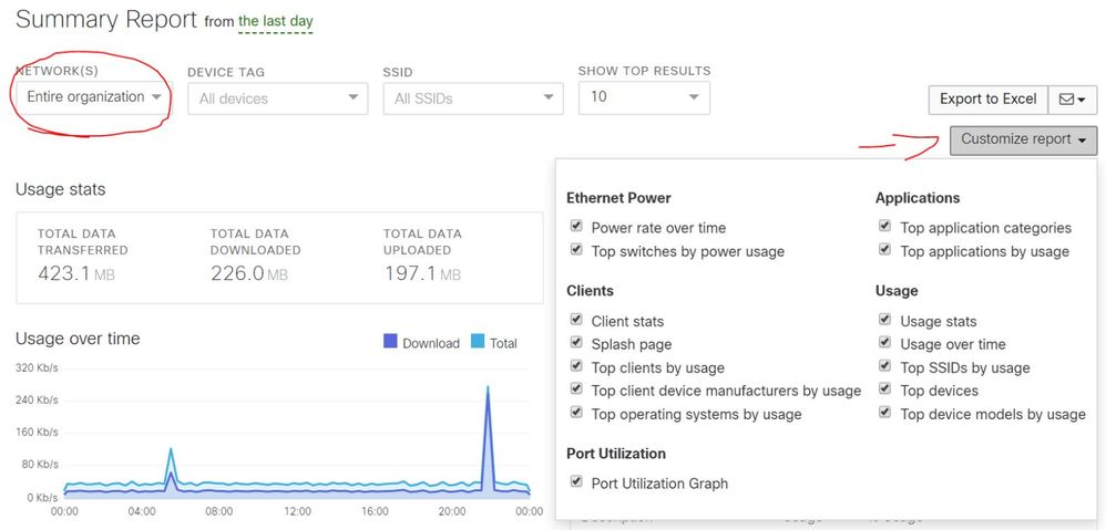

Hey all,
quick question...
I scheduled some weekly reports for non IT collegues. I don´t want them to see Application usage.
Can I schedule a second weekly report for myself (same Wifi) including the application usage?
Also, when switching between two wifi´s within the summary report the customization seems to be overwriting past settings. Will these be shown in the next report?
Example:
Wifi-1: showing only top devices
Wifi-2: showing all within the summary which is possible
When I schedules Wifi1 first and then Wifi2, switching back to Wifi1 will show all possible options. Is it only showing this or will it be in the report as well?
As these reports have been scheduled, I´m afraid to test/change something at the moment.
MarcP
It is unfortunately not possible to create two reports for a single SSID.
And changing the coloums seem not to change an existing report. Only when you change something and then go to manage existing reports. Then edit it and tick the "Current view".

CptnCrnch
You can build "views" for Summary Reports, but I don't think you're able to exclude Application Usage.
https://documentation.meraki.com/General_Administration/Cross-Platform_Content/Summary_Report_Overvi...
MarcP
thanks cptn, had a look into the doc as well, but couldn´t find my question answered, if it is possible to set dfferent reports for a ssid with different "columns"
CptnCrnch
From what I can see, I don‘t think this is possible with the current reporting. Guess your best option is using the API to pull off the things you need.

MarcP
@Inderdeep , sorry but this does not answer my question really 😄 😉 Or I don´t see it.
2 reports (for different receivers) for a single SSID with different columns.
MarcP
OK, set up a temporary guest wifi and scheduled a report.
Afterwards (for the same ssid) changed some columns, receivers and scheduled this report with a different name.
Then checked all scheduled reports and only one report was shown. Seems like it is not possible the way I want it to be.

MarcP
Made a case as well on that:
Time to make a wish again 😞
