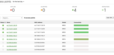

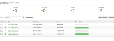

@GagnonCo Can you please post a screenshot of what you are seeing please.
Meraki CMNO, Ruckus WISE, Sonicwall CSSA, Allied Telesis CASE & CAI
I have all the equipment wired together, with new MS120-48p into the old MS120-48p, and from the new MS120-48p to the first MR74, which will be used with the second MR74 as a repeater, which is then wired to the the MS250-24p. I have not turned on the 3 new MR33 yet, so they would not be expected to show up.
