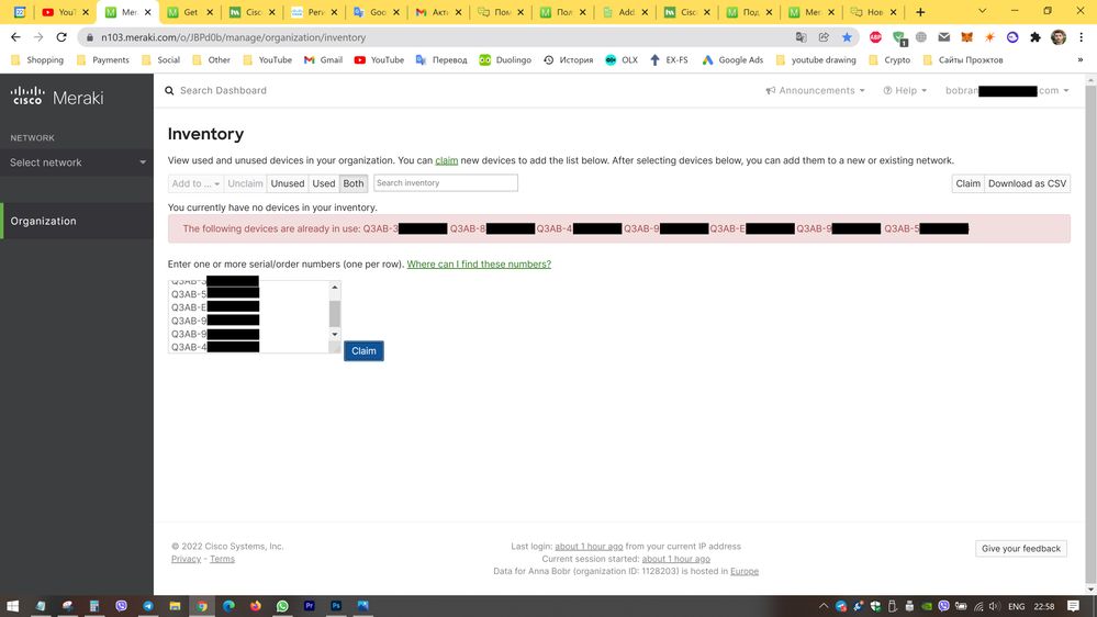

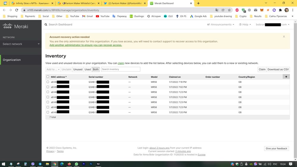

Hello. In early January, I added 7 devices to my inventory. I bought devices online, they gave me codes, and I'm still waiting for units. I added the codes to make sure they work.

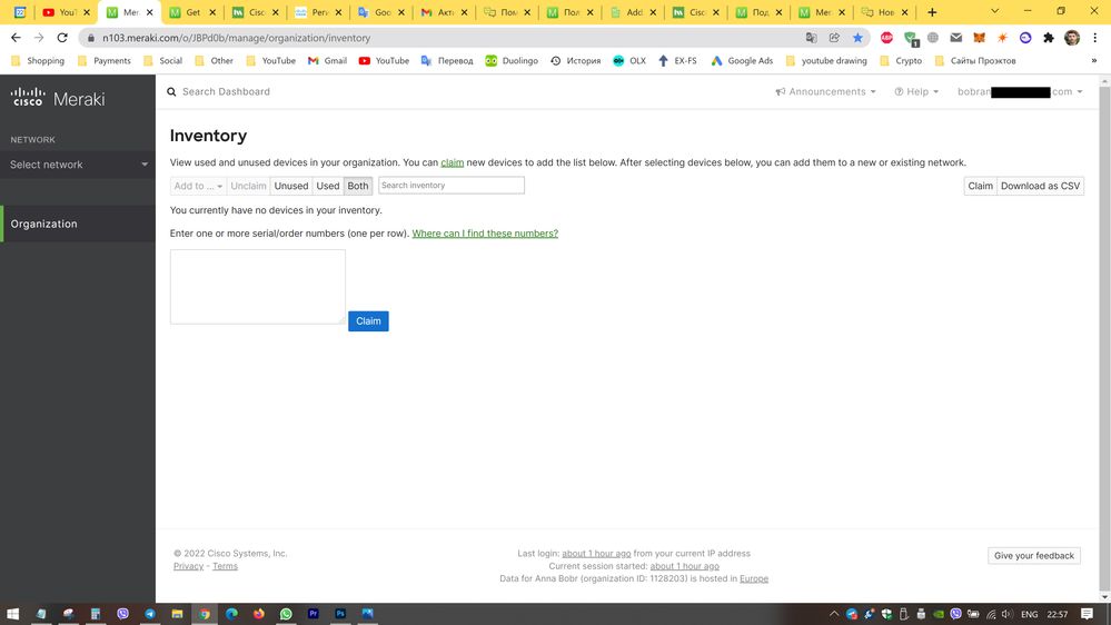

but today when I checked they disappeared. Now I sign in and it says to me that the inventory is empty. Where did my devices go? I'm attaching a screenshot of where they were added. If I try to add them again, it says that they are already in use. Help me how to fix this?

Where did you buy the gear? I can see the serials are now in another customer's org.

I bought them online, and when i claimed the devices to make sure they were unclaimed they added to my account. So I was happy with the purchase. Could you please tell me how it's possible that they got removed from my account and got attached to someone else's ?

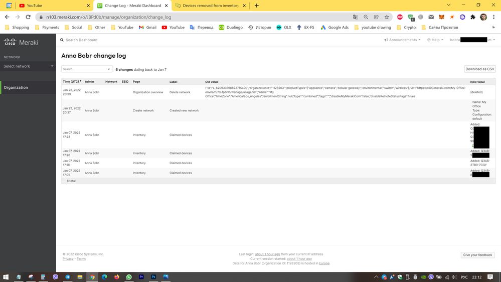

Hi @AnnaB like @Ryan_Miles I can see the APs in another customer's Dashboard organization (actually two Orgs), as if they were never unclaimed from those Orgs, however they were never online or in use.  When you say they gave you the codes, do you mean the serial numbers, or maybe an order number and/or a license key?  And you say you claimed these 7 APs and they did in fact populate into your Organization > Inventory?
If so, and you did not unclaim them yourself, nobody else would have been able to claim them, it would give the same error that the devices were "in use" because they're already claimed in your Org.
You'll probably have to open a case with Meraki Support and the partner/reseller you purchased the APs through.  Meraki Support should be able to investigate the order history and if and how these APs were ever claimed into your Org and/or removed from your Org and how they ended up in another customer's Org.

Correct, a full org admin can remove a device from a network and unclaim it from the org, at which point it could be re-claimed into another org, perhaps by a completely different full org admin. In this case it seemed like Anna claimed devices into an org and then somehow were no longer in the org, so trying to figure what went on and where these serials existed and when and how they were purchased to try to determine if some online 2nd hand seller was running a scam.
