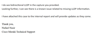

VRB
Below is the reply from support.
spaladug
A fix just got pushed out a few hours ago. Please check if the LLDP information is visible now and inform your Meraki Support Engineer of the results if you have a case open.

VRB
LLDP info is back. Thanks.
