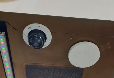

cmr
If you have an actual ceiling (as we do here) then you can just cut a hole in it and use the supplied nut:
DarrenOC
Is that where I think it is @cmr ?
cmr
Yes, it is on a 'ceiling' 😉
