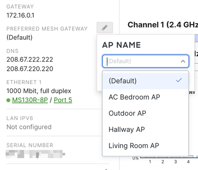

ConnorL
You can choose in Dashboard which AP you'd prefer the repeater to use - for more info see: https://documentation.meraki.com/MR/Wi-Fi_Basics_and_Best_Practices/Wireless_Mesh_Networking#Preferr...
