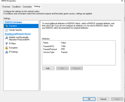

If ping does work, you might have an MTU issue, especially if you use certificate-based authentication. You can try configuring the Framed-MTU attribute on your RADIUS server for lower and lower values (1400, 1300, etc.) until it starts working (or use "ping -f" to figure it out properly).

Change in MTU Helped! It works now.  i've set it to 1344
