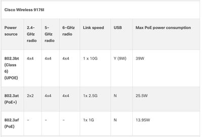

There are very import PoE caveats if you don't have UPoE available.
I have Meraki switches ... 😞

The most important table:
https://www.cisco.com/c/en/us/products/collateral/wireless/catalyst-9100ax-access-points/wireless-91...
and for the 9178:
This means the 9176 will likely give more value if UPoE won't be available in your network anytime soon.

Really hoping they're just needing an extra few months to bring out a 9174...
We don't have the $ to go out and replace our .3at 9K switches with .3bt capable switches so there's no point paying a 9176 price to run it at equivalent 9164 specs, unless they come to the party with lower pricing!
