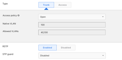

So first and foremost, here is the switch trunk configured for the AP:
As for the first problem, if I configured static IP on the AP and tag it with VLAN 100, it doesn't work. BUT if i remove the tag on VLAN 100 and keep the rest of the configuration, it works. Why is that?

1 and 2 are the same problem.
You are trying to send a tagged vlan 100 packet from the AP, while vlan 100 is your native(untagged) vlan on the switch.
Meraki doesnt allow this.

The native VLAN is always untagged. The AP needs to match this config.
The easiest way to do it:
- Put the AP onto the native VLAN
- Tag the WLAN traffic into the other VLANs.

Hi Karstenl and thanks for the information.
Your suggestion is exactly the configuration I screenshot above.
The AP is on the same VLAN as the native VLAN (VLAN 100) on the trunk.
The WLAN's is tagged to VLAN 40 (working) and VLAN 100 (not working).
Or maybe I misunderstood you?

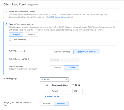

If you want the SSID to work on the APs native VLAN then you need to remove the VLAN tag on the SSID.
So set this to Disabled:
