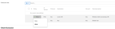

The first thing to check is whether you've set firewall of the SSID to allow local LAN traffic, as on the first SSID slot this is disabled by default.

As already mentioned, no client Isolation and Firewall Rules allow access.
