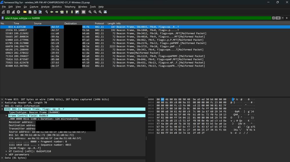

However, we happened to have an employee staying at one of our locations and reporting that the guest WiFi network was not available. We looked at the AP in question, and it shows broadcasting. Upon doing a packet capture, we again noticed no beacons, just malformed packets. A reboot of the AP does not resolve the issue. This is not using a teleworker VPN, just the straight internal Meraki DHCP option.
If you've had users complaining about WiFi not showing up or weak signal and written it off as user error, you might want to do a packet capture to see if the SSID is actually transmitting, as the dashboard UI does not seem to reflect if it actually is. Pay particular attention if you are using a teleworker VPN/concentrator as well.

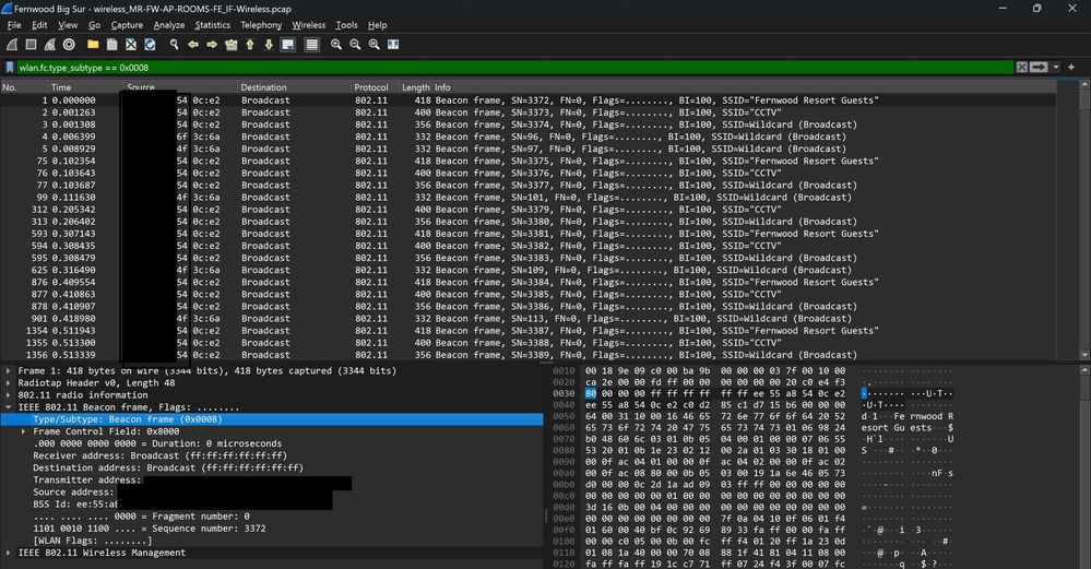

Take a look at the screenshots. One shows the correct operation - beacons being broadcast for all appropriate SSIDs. The second one shows no beacons, just bad packets. The second SSID shows in the dashboard as functioning normally, and there are no error logs or event logs we can ascertain.
Has anybody else seen this behavior? Running 30.5. The hotfix applied by support was to the MX, not the MR.beacons-bad.jpgbeacons-good.jpg
