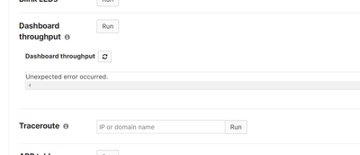

Within an hour of posting above, issue at one site, 6 out of the 8 MR44's there with he same problem.  Below is the message I captured when trying a throughput test.  Toggled PoE on switch ports, AP's recovered.  I'm hoping there is a site in the future with the issue on an AP that's not customer critical so I can investigate further with support while it remains in it's broken state (before rebooting)

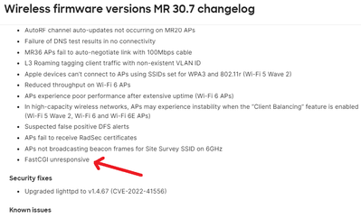

For completeness in case anyone else is suffering the same issue as us, well, I logged a ticket with support, turns out this issue was introduced in an earlier version of firmware, 30.5 I think, is resolved in 30.7.
The issue is called 'FastCGI unresponsive'.  Yep, good description that, dunno how I didn't seen that in the release notes and guess that was related that to my problem and apply the firmware update sooner (despite worried about radius authentication issues in 30.7.....)...
