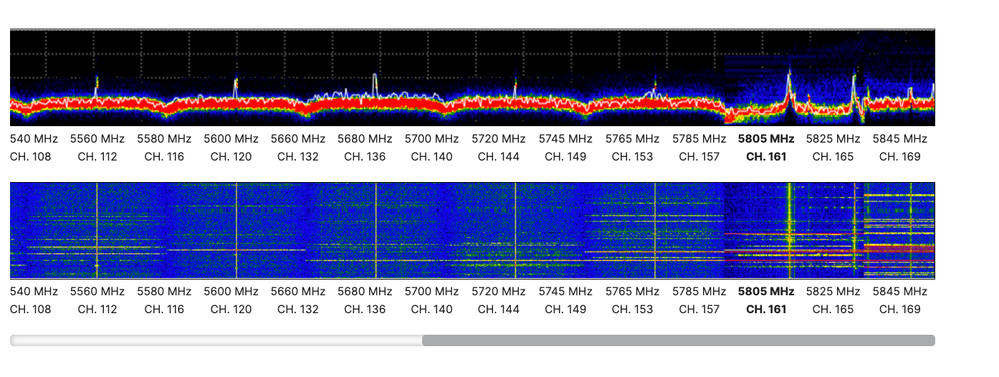

I'm seeking a bit of help on understanding our RF spectrum graph.
We had a report of some client issues - packets being dropped on ping to 8.8.8.8.
The AP is operating on ch 161, it is a MR57
Taking a look at the RF spectrum graph ch 161 did not look like it was operating normally.
I'm trying to determine if it is a source of RF interference, or the AP is misbehaving/faulty.
I've looked at other causes of the potential packet loss - but everything else looked normal.
Any help would be appreciated.

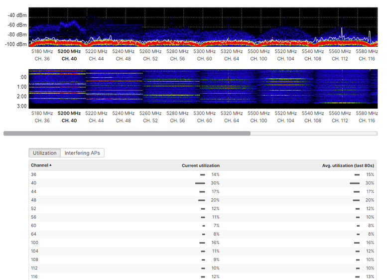

Here you can see an AP on channel 40 that is slightly suffering, but in realist is working fine, what does the table below show for your one?

i've attached the table as well.
cmr
The utilisation of 161 is 0% so that shouldn't be the problem, though I did check a 9166 and the graph is all over the place.  Newer models often take a while for this part to be right...
