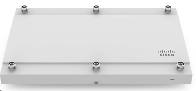

Do anyone have a picture of the MR46E antenna ports / layout ?
On the datasheet and installation guide, there is no "map" of what port it for scanning, IoT and the normal 2,4/5 WiFi.

Yes ... But of the 6 ports ... what port is what ?
I cant find any pictures online of this.

RaphaelL
If you look close you can see the labels.  I went on google image , try to find a high res image. I can't upload it here
RaphaelL
1-2-3 =   2.4/5 -  SCAN - 2.4/5
4-5-6 (cisco logo) = 2.4/5 - IOT - 2.4/5

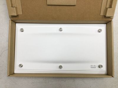

But isent that image the MR42E ... is the portlayout the same on the 46E ? (me not knowing or remembering 🙂 )
I see from the below image that they are the same ...
Thanks everyone.
