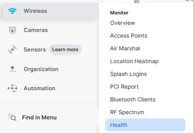

Try the AI assistant:
Ask a question like:
Diagnose WiFi connectivity issues from the last 24 hours.
If you know a specific client, add that to the prompt.
What does Wireless Health report?
