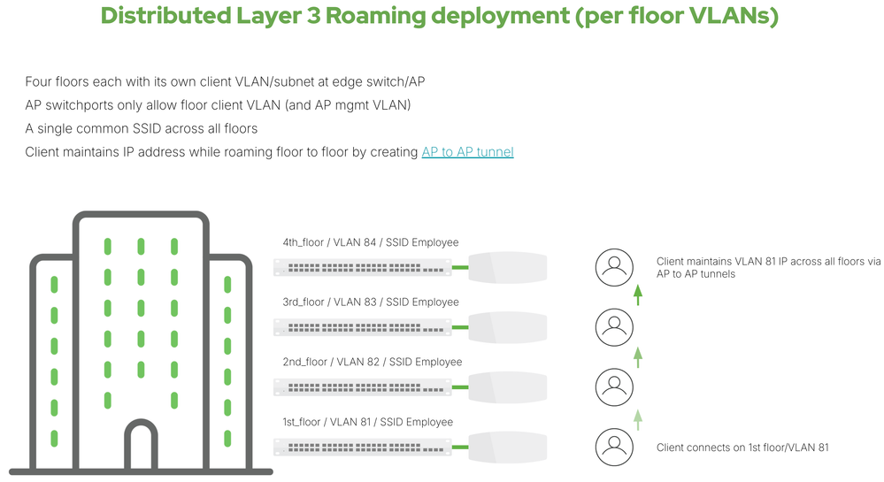

If SSIDs are bridged to a single VLAN don't check the L3 roaming box. That only applies when you have multiple VLANs configured for the SSID. Example, a building with 4 floors and each floor has a unique client VLAN/subnet. L3 roaming could maintain the original IP when devices move between floors.
If you have a single VLAN for the SSID the L3 roaming feature isn't doing anything and could actually lead to issues.

Some general areas I'd look at are the following.
