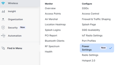

I haven't seen this anywhere and just noticed. This seems pretty useful for folks that want to upgrade before they can meet the PoE Requirements. Under Wireless, Power Settings. Basically the different options let you pick which radio goes down to 2x2 from 4x4  (or off -9178) or which nics work if you have a 9178
https://documentation.meraki.com/MR/Operate_and_Maintain/How_Tos/Features_and_Integrations/Power_Set...
