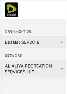

I dont have access to etisalat
I have access to Al Aliya

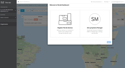

When I go there I get this
And I an unable to register the MR
MarcP
OK, before you are able to claim the device to your organization, someone from the old org has to delete it from the existing network, than unclaim it in the organizations inventory.
After it has been unclaimed, it may take a couple of minutes until you can claim it.
As it is still in the old organization, that´s why the old SSID is still shown.
