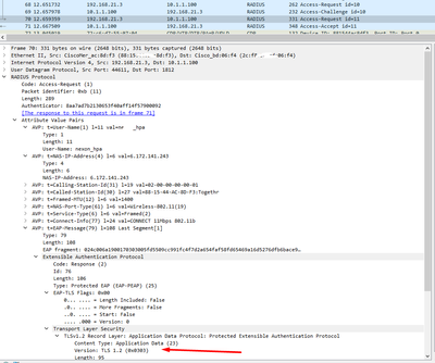

"Site B" does the tests from the Dashboard Radius test button using TLS1.2 which is configured correctly on the Server.
"Site G" does the tests from the Dashboard Radius test button using TLS1.0 and is rejected as the server is configured to disable TLS1.0.
The clients running on the LAN are correctly using TLS1.2 at "Site G" the only place that TLS1.0 is used is on the Meraki Dashboard Test.

"Site G"
"Site B"
"Site S"
