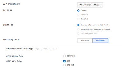

    PSK (WPA3-SAE Transition Mode)
    802.11r Enabled

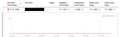

Some Meraki Screenshots and event IDs
I know it looks like the event IDs signify driver / firmware issues - but they are on the latest release n-1
802.11r Enabled
802.11w Enabled

Hello ,
That is interesting , So we have a requirement to be on WPA3 , however i have not tried setting it to WPA3 only without SAE.
i presume just WPA3 will be ok ?  - eg below?
I cant recall us setting SAE explicitly , but perhaps it was auto enabled when we set it to WPA3-Transition mode.
WPA3 works fine, but you need all Wi-Fi 6 clients.

If possible could you send a screenshot of a example config of WPA3 you have that is working reliably with your HP/Dells?
JimBean112
Hello
So i wasnt able to set it to WPA3 without selecting SAE or SAE-EXT as it needs a specified AKM suite.
Wifi 6 clients is fine , all our corp devices are compatible.
would you have a screenshot of the settings where its just WPA3 without SAE ? as i dont think its possible in the release im on
or did i miss understand and it was to use WPA3-SAE rather than WPA3 Transition SAE?
thanks!

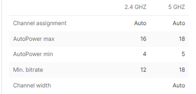

Can you check the interference level of APs?  What is the channel width (Auto or manual)? How is roaming occurring between the APs or between the same radio on the same AP?
