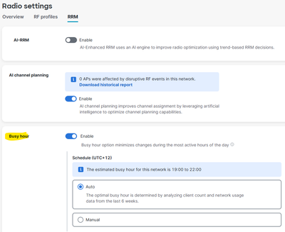

I am not 100% sure what you are asking, but if you want to prevent the access points from changing frequencies during the working day, you can set the "Busy" hour under Wireless/Radio Settings.

What you could do is restrict the available channels that can be used in Wireless/Radio Settings to those that are allowed across all of the countries where you have an Internet breakout.
This way, there is no way that a channel will be turned off if the AP suddenly if it finds itself in a different regulatory zone.
