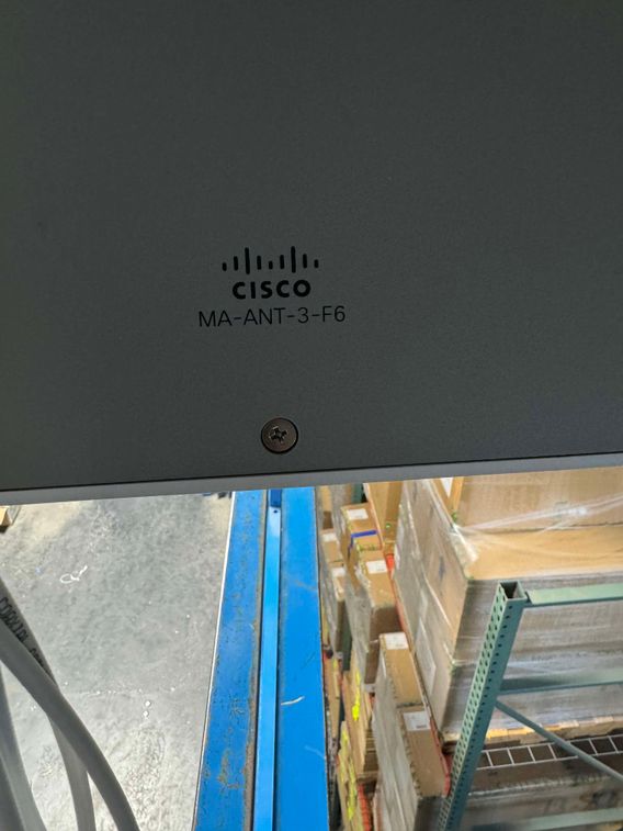

I am having some issues with my MR46E devices in a warehouse setting. Each device is equipped with the Narrow Patch (MA-ANT-3-F6) antenna, but I have noticed that all of them are auto-detecting the Wide Patch (MA-ANT-3-E6) antenna. Despite my attempts to manually change the settings, the Dashboard indicates that the devices are auto-configured. I have already sought assistance from Meraki support, but they have not been able to provide any solution. For your reference, my devices are running on firmware MR 29.7.1.
Has anyone experienced this behavior before in their installations or have any other solutions to offer?

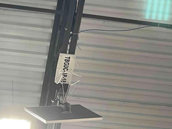

Do you have photos of one of these installed APs and antenna?

Sorry for the late reply.
A ticket has been opened with the original order number of the Antenna and APs.
I discovered a crude workaround that worked on one unit, but due to the time and service disruption, I have decided to wait for a fix. I have left the others untouched.
The "fix" involved unclaiming the device, factory resetting, re-claiming, configuring, manually setting the antenna, and placing the AP back in service. This resulted in about an hour of work on a lift and in the IT workroom to make necessary changes. My company prohibits electronic devices on scissor lifts which added time.
