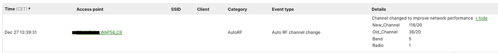

I've recently upgraded some of our networks to MR 30.5 firmware and noticed that some APs aren't broadcasting the right channel assigned by AutoRF.
I've thought about DFS events, but none are visible in event log.
Also I'm not sure that this behavior was seen before upgrade to MR 30.5 , but cannot confirm.
For example, on one of our APs, AutoRF event is showing channel 140 as assigned for radio 1 (5GHz) :

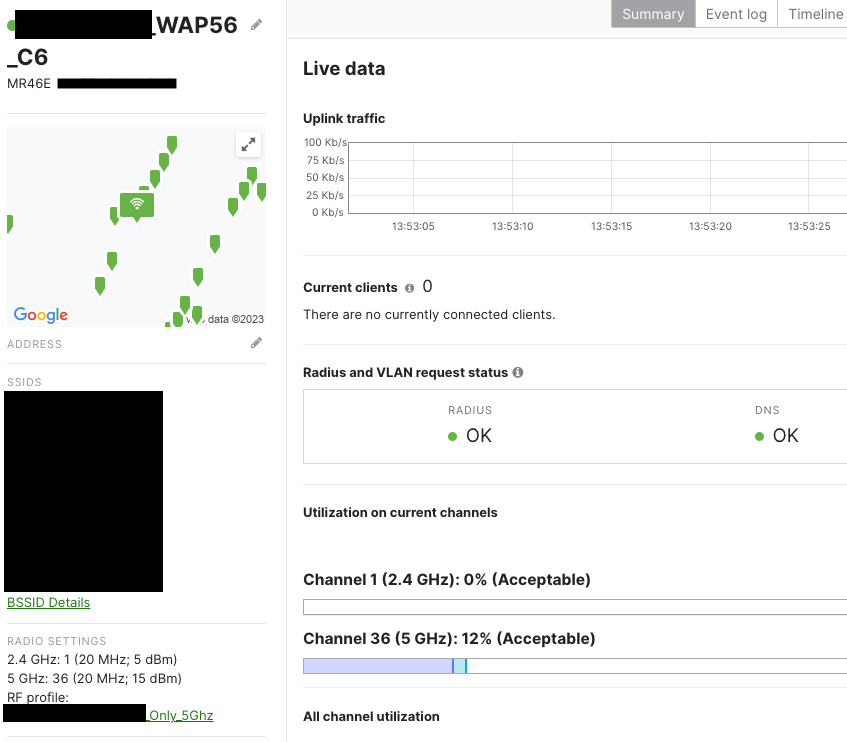

However, the AP keep broadcasting on channel 36, even after waiting few minutes after AutoRF event. The config status is up to date at screenshot time :
Has anyone ever experienced the same problem ? I'd like to understand what's going on with AutoRF as the channel management is not optimal on this site.

Hi @cmr , that seems very similar !
I've called support yesterday when I had the issue, they told that according to backend logs, the AP is taking the AutoRF channel change, but for an unknown reason, the AP is reverting (without logs) to original channel.
Also, we were warned about our number of SSIDs (8) which can cause higher CPU usage on AP.
I'll try to upgrade another network with fewer SSIDs to see if the problem occurs
