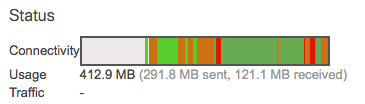

I am seeing the same issues on the network of a client.
At the moment it's fine again without changing anything. I'll log a support case as well with Meraki.
I'de say keep this topic up to date with any feedback you get from the support team.
I checked the firmware releases and even in Beta I don't see any fixes for this issue.
