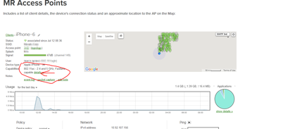

What is the Client data rate statistic?
Riser
I will appreciate if you can guide me on how to check this and revert back.
https://documentation.meraki.com/General_Administration/Monitoring_and_Reporting/Client_Details_Page...

It's a good way to troubleshoot client speed issues.
https://documentation.meraki.com/General_Administration/Tools_and_Troubleshooting/Troubleshooting_Cl...
