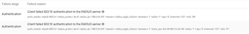

Authentication client failed 802.1x authentication to the RADIUS Server issue
Dear All,
I'm currently facing an issue with one AP in our customer's site, one AP has the following warning with specific ssid, whereas the rest of the AP do not have such issue, i have ran the radius test in the portal, but all of them has passed the radius authentication test, also i have tried to look for the NPS radius server logs, i couldn't find any authentication failure related, any help would be appreicated

i checked in Radius side the AP has permitted in the server, and other endpoint could successfully connected to the internal SSID, the radius authentication has passed, its only sometime i see such unauthentcation log appear for this AP, i could perform a packet capture to the radius to see any abnomral issue

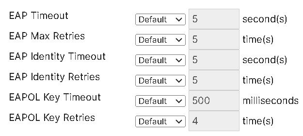

shall i try increase the timeout ?

Try and increase EAPOL Key Timeout to 1000ms

at the same time i'm checking the NPS radius logs see any finding, may be i can increate the EAPOL Key value as well

i have increased the Eapol timeout to 1000ms, thanks
