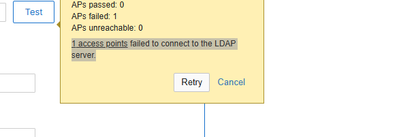

I am currently moving a network over to a new SSID that will be using an LDAP connection. We have gone though the documentation and created the cert to be used with our main DC (local), as well as created an admin account with read access. The cert is using the FQDN for the DC, and the search base DN is configured to use the entire directory (DC=domain,DC=org).
I run the test connection and the AP fails to connect to the server.
I tried both port 389 which gives the error:
I test port 636 and get:
The only thing I can think of is that I was given a public cert from systems, and not sure if I need the private.
I am not sure. I am not systems and ignorant of what I need to communicate over to them because this seems like a cert issue.
Other details just in case: I am using MR44 APs that are fully up to date. I don't see blocking on the firewall.
Any information on this helps.

Can your AP ping the LDAP server? You need that basic connectivity before anything else. Also port 636 is LDAPS not 626.
If you can ping the server and neither port works you may need to packet capture to see what is going on. At least in cleartext (389) you will see exactly why it's failing in the ldap messages from the server. It's a bit harder with SSL.
It sounds like a new setup so your AD admin may need to look at something  like this: https://learn.microsoft.com/en-us/troubleshoot/windows-server/active-directory/ldap-over-ssl-connect...and verify things work in general.

That was a typo. I meant 636. The AP can reach the server I ran a packet capture and there is a successful handshake. I will pass the information on.
vagrant
I ran some more captures and found out that there is an issue with the CA. I am going to get with support and systems to get them to give me the correct CA. I appreciate the help.
