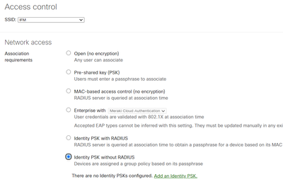

Hello I am trying to enable the feature: "Identity PSK without RADIUS", but i do not have this option in the list:
When i go to "Wireless">Access Control , i do not see this option.
My AP is a MR74 with firmware MR27.6 connected to a MS320 Switch in version MS12.33.
I don't understand why i do not have this option available.

It's under the SSID settings, not access control.
Ssid -> choosing the ssid and edit ssid = access control, like on your screenshot 😉
Or directly click on access control under wireless.
