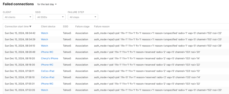

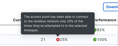

Hello!
I'm receiving high association failure rates on 2 my 4 access points in a home network.  I'm currently sitting with line of sight (20') to a Meraki C9164AP that's directly connected to a MR75.   Speeds are good when connected but its discouraging to see such high failures.

@Wade_Carroll I'd turn it off, it is only really needed with 802.1x or similar authentication, simple psk should roam fine without it.

It looks like you are using WPA3 (as you need to for the 6GHz band to work), I have found that to be substantially less stable than WPA2 on the same AP and same endpoint.  Also remember that 6GHz signals travel about 10-20% less far than 5GHz.
That is also my experience.  If you want to use WPA3, put it on a seperate SSID.
There is poor device compatibility with WPA3 at this point in time.

I do have 802.11r enabled on WPA3.  Could this cause the high association rate fails on apple devices?
cmr
