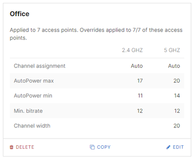

My question is related to the fact that after I configure my profiles to deliver the AutoPower max and AutoPower min to the values I want, the access point stills uses more power than the configured value even when it is attached to a profile.
Here my profile values:

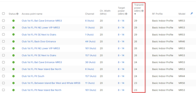

Now, here's the power delivered by access points.
Why are do I have those APs delivering more power than the configured value?

The APs will eventually reduce Tx to come in line with the profile selected. Give them time.

It hasn't come down since I installed the APs almost 8 months ago

Have you checked the beacons? I had this at home recently where the dashboard was telling me one thing, but the AP was actually following the RF Profile (I checked with WiFi Explorer Pro)

I just want to understand why power on my APs goes above the configured range. I understand that most of the replies are focus on roaming and that sort of things. The clients in the network are POS handheld terminals, like the one you see on restaurants to pay your bill.
So, no much I can do on the client side since they are almost "dumb" clients.
However, I can configure the APs so they do not transmit way to much power (my environment is a high density one) so when a client move it roams to the closest AP. Unfortunately, most of my APs are not using the configured power range and transmit way too much power than needed.
I need to understand why and how to bring the power down.

If we are observing that the APs are not obeying the configured RF profile settings and there are no manual overrides specified then I would encourage you to engage Meraki support and open a case. Based upon the date of the initial post if APs have not lowered their power transmission in about 24-48 hours then there could be a greater issue.
I have observed scenarios where APs will not transmit at a forced maximum power due to regulatory domain restrictions, but I have not come across the opposite where they will not lower their maximum power transmission.
